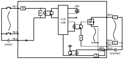

QX48Y57外部连接图:
QX48Y57 http://www.fx-plc.com/baike/240.html
